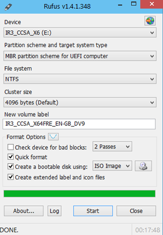

Insert a USB memory stick with a bootable UEFI USB drive with Windows 10 Setup on it, USB3 is quicker but USB2 works also. A Windows DVD won’t work unless you’ve created your own UEFI Bootable DVD.
How to create a bootable UEFI USB drive with Windows 10 Setup
