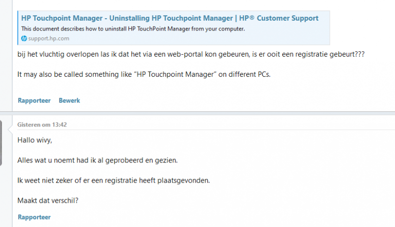

in #4 vroeg ik of er een registratie gebeurd is via internet?
' Maakt dat verschil? ' ... ' als die remote aangezet wordt ' ????? :unsure:
@Skippy TS zegt al meteen in de eerste vraagstelling dat hij dit heeft gedaan, herhaaldelijk.
Maar ik lees vooralsnog nergens dat hij de service gestopt heeft en de aanpassingen ge-safed heeft.

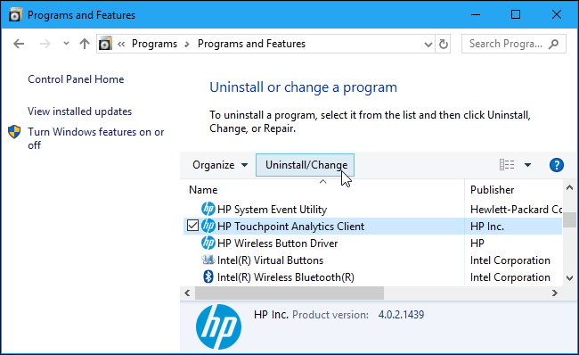

Option One: Uninstall the Software​
Thankfully, you can uninstall this software if it’s on your computer. To do so, head to Control Panel > Uninstall a program. You can also just press Windows+R, type “appwiz.cpl”, and press Enter to go straight here.
Select “HP Touchpoint Analytics Client” in the list and click the “Uninstall/Change” button to remove it from your PC.
If you don’t see this application, you don’t have the software in question on your PC. It may also be called something like “HP Touchpoint Manager” on different PCs. Look for anything beginning with “HP Touchpoint” here and uninstall it.

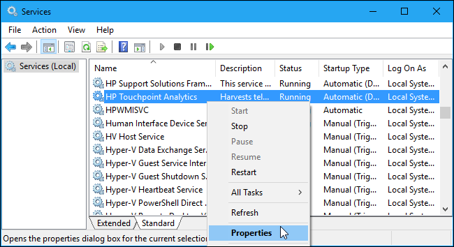

To do this, open the Start menu and search for “Services”. Click the “Services” shortcut that appears. You can also just press Windows+R, type “services.msc”, and press Enter.
Scroll down in the list and locate the “HP Touchpoint Analytics” service. Right-click it and select “Properties”.
First, click the “Startup type” box and set the service to “Disabled” to prevent it from automatically starting in the future.
Second, click the “Stop” button to stop the service.
Click “OK” to save your changes.
The service is now disabled and it should no longer run. Hopefully, HP won’t play any tricks and reinstall or re-enable this software in the future, but you never know—so keep an eye out.
